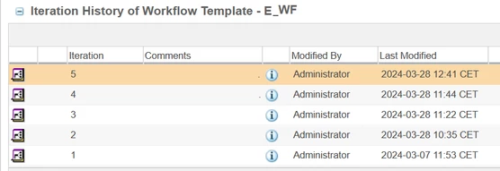

Understand.
Just one point, The history of the workflow can not be lost. Windchill keeps the iteration history of the workflow even though the updated version is imported from the ZIP
I would say that the xml comparation is the only way I know today.
