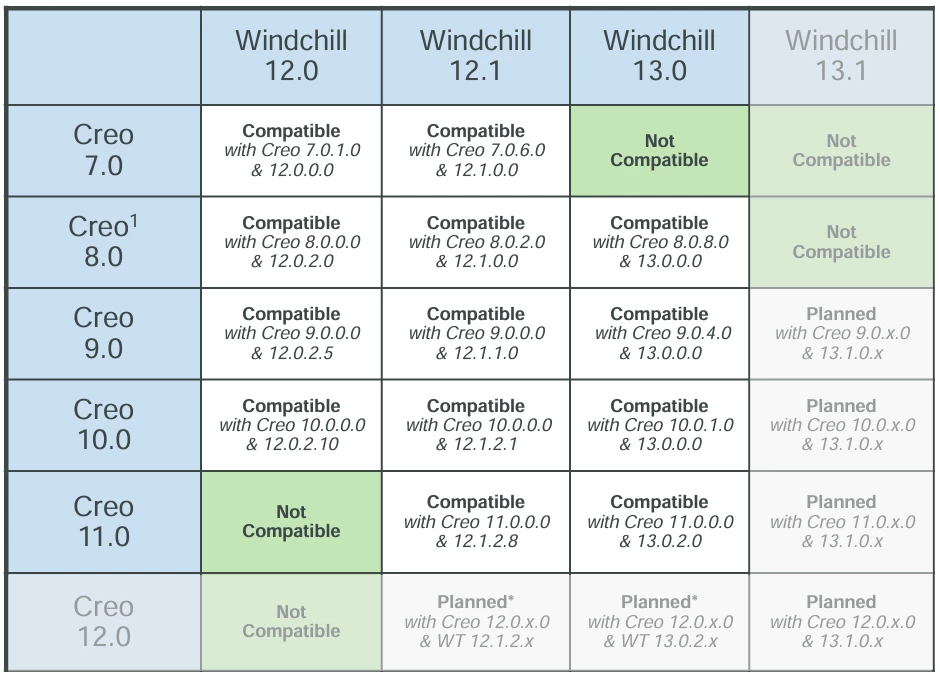

I am currently analyzing the compatibility of Creo Parametric 9.0.4.0 and Creo Parametric 11.0.0.0 with Windchill 13.0.2.3. Based on the official compatibility reports, both Creo versions have different minimum Windchill version requirements:
  • Creo Parametric 9.0.4.0 is compatible with Windchill 12.0.2.0, including 12.1.0.0 and 13.0.0.0.
  • Creo Parametric 11.0.0.0 requires Windchill 12.1.2.8, including 13.0.2.0

This matrix gets updated often but here is latest:
Typically, when they say that a version is compatible with 13.0.0.0, you're good for all maintenance and CPS updates of version 13. Creo 11 is supported only at 13.0.2 and beyond. I think you need to be more specific in your question. "Any known issues" is too broad. Bugs or other things would be captured in the release notes or knowledge base if observed. My suggestion in any upgrade is to stand up your target environment, do a rehearsal and run through validation against both Creo version to be confident is nothing that would impact your company specifically.

I am running Windchill 13.0.2.3 with both Creo 11.0.3.0 and Creo 9.0.9.0 in production.
My Windchill servers are all Windows 2019 and we use Oracle 19 for the database.
