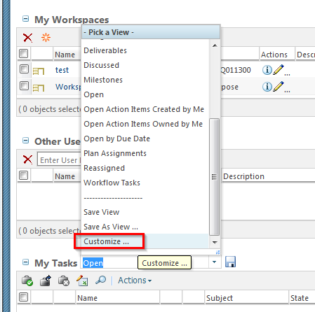

Is the dropdown for the Home, Tasks table set to All instead of Open?
Apr 12, 2017 4:45 PM UTC
No drop-down is set at "All Open"
We have changed to different items in drop-down and still the task remains
22-Sapphire I
Apr 12, 2017 4:49 PM UTC
Then for this user, it will grow without limit to show all tasks.  Need to set to Open in general - use All only to review completed.
Apr 13, 2017 7:51 AM UTC
How long a completed task stays in the system is controlled by the following preference setting.
Even if you sett to ALL, it will still delete in small batches so not disappear immediately.
Completed tasks which are not deleted by system have to be filtered with a table view. If this is not happening, then worth checking the configuratoin of the table view you are using.

Something else is going on here.  Work Items are available in the database to report on after the fact and should be left in place (e.g. how long did it take for Marketing to Approve ECR's during the past quarter).
A user's Home, Tasks table's filter for Open or some variation of Open should filter out those which have been completed.  This one has my curiosity now - would be happy to take a look live.
