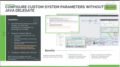

Apr 14, 2025 2:36 PM UTC
Apparently this is OOTB functionality as of 12.1.2.0, but my Windchill admin and I must have missed it in the documentation. Still digging, but looks promising (if it works as flawless as described)
https://community.ptc.com/t5/Windchill-Ideas/Add-Windchill-parameters-for-latest-change-number-and-where-used/idc-p/1010548/highlight/true#M18831
HelesicPetr
Apr 15, 2025 7:54 AM UTC
Hi @JDiluzioQinetiQ
The attribute has to be added to the drawing table or somewhere on the drawing.
The visualization has to be regenerated after approval (usually done by code in the workflow), and the visualization worker has to be configured to regenerate the drawing during the visualization process.
Then it should work.
