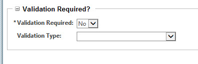

Oct 3, 2016 4:40 PM UTC
I'm just starting to test on 11 and not having much luck.
This is on the CR "Set Attributes" page. I have a Global Attribute called "Validation Required" with a Enumerated Value List of Yes, No.
Then in a second attribute called "Validation Type" that is Required also, the Required has a Conditional of upstream "Validation Required" = Yes then Validation Type, Required.
This is how it is displaying:
