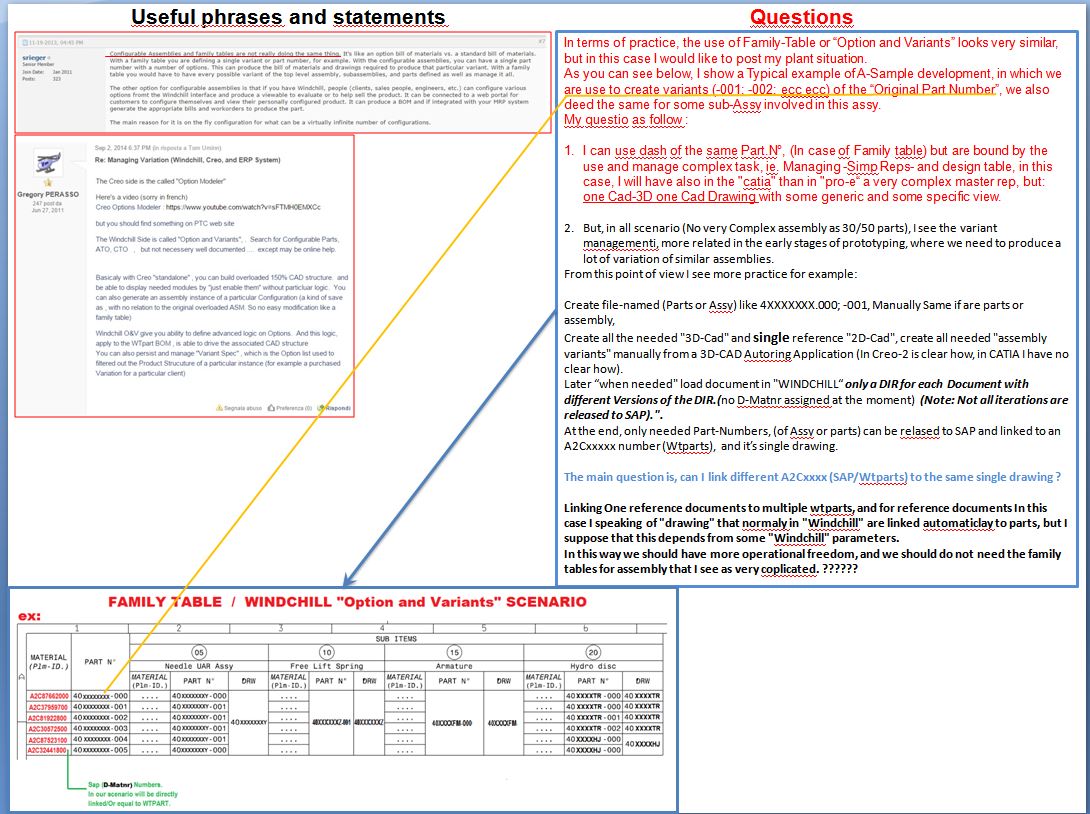

Configurable Assy Vs Family/Desing Table Vs OtherWay (CATIA/CREO)
ConfigurableAssy-Vs-FamilyTable-Vs-OtherWay.jpgIn terms of practice, the use of Family-Table or “Option and Variants” looks very similar, but in this case I would like to post my plant situation.
As you can see below, I show a Typical example of A-Sample development, in which we are use to create variants (-001; -002; ecc ecc) of the “Original Part Number”, we also did the same for some sub-Assy involved in this assy.
My questio as follow :
1.I can use dash of the same Part.N°, (In case of Family table) but are bound by the use and manage complex task, ie. Managing -Simp Reps- and design table, in this case, I will have also in the "catia" than in "pro-e“ a very complex master rep, but:one Cad-3D one Cad Drawing with some generic and some specific view.
2.But, in all scenario (No very Complex assembly as 30/50 parts), I see the variant managementi, more related in the early stages of prototyping, where we need to produce a lot of variation of similar assemblies.
From this point of view I see more practice for example:
Create file-named (Parts or Assy) like 4XXXXXXX.000; -001 Manually, Same if are parts or assembly,
Create all the needed "3D-Cads" and single reference "2D-Cad", create all needed "assembly variants" manually from a 3D-CAD Autoring Application.
Later “when needed" load document in "WINDCHILL“ only a DIR for each Document with different Versions of the DIR.(no D-Matnr assigned at the moment) (Note: Not all iterations are released to SAP).".
At the end, only needed Part-Numbers, (of Assy or parts) can be relased to SAP and linked to an A2Cxxxxx number (Wtparts), and it’s single drawing.
The main question is, can I link different A2Cxxxx (SAP/Wtparts) or diferent 3d CAD Parts to the same single drawing ?
Linking One reference documents to multiple wtparts, and for reference documents In this case I speaking of "drawing" that normaly in "Windchill" are linked automaticlay to parts, but I suppose that this depends from some "Windchill" parameters.
In this way we should have more operational freedom, and we should do not need the family tables for assembly that I see as very coplicated. ??????

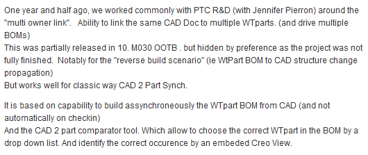

But for the 3D. Do you mean same 3D to n Wtpart ?
if it is one 3D CAd model for one WTpart. no problem . it is also out of the box in Windchill (owner association)
if it is one CAD part to n WTpart. more complicated. but exist . Just that not fully released in Windchill 10.2. But works already pretty fine. If that case , I can provide you more detail

If I understand what you are trying to do, you want to link (Associate) multiple CAD Documents to one WTPart? I can't speak to the SAP side of things but I'm assuming that a WTPart would equate to an SAP Item Master entry.
So the answer is yes. You can set different types of Association (linkages) between WTParts and CAD. There can only be one "Owner" (CAD drives structure and attributes), but there are other types as well (Contributing Image, Image, Contributing Content, Content). I encourage you to refer to the Help files to understand the differences (I don't have exact differences in memory). A word of advice, only one of Owner or Contributing Image Association types.
I would caution against the use of family Tables for complex assemblies (best suited for same shape different size like fasteners etc.).
Options and variants is a way to define Configured WTPart Structures (BOMs) based on choices and selection logic. There is an add-on module for Creo that will drive the Windchill configuration into the CAD model.

thank you very much for your response, before to give a comprehensive answer to your suggestion, I will deepen on the help file to understand better the different types of associations, and the relative conjunction from SAP side.
But you have hit the mark, the main question is to find a best practice, to avoid the generation of a lot of different drawing numbers, at least for the early stages of development, this also because we are in the middle, of a project for the personalization, by PTC and Head quarter in Germany, In this phase only macro problem (More related plus on simple SAP production management, and it's products life cylce management are the focus, but not all the aspects and problems on the start-up phase of development more over related to different plants and locations.
Thank you very much, I appriciate however, that we will continues to deepen on this topic, even after my comprehensive answer.

I'm not sure if it's helpful or not, but there was a discussion a while back on configuring Windchill to allow multiple owner links from one CAD document to multiple WT Parts.
http://communities.ptc.com/message/248564#248564
