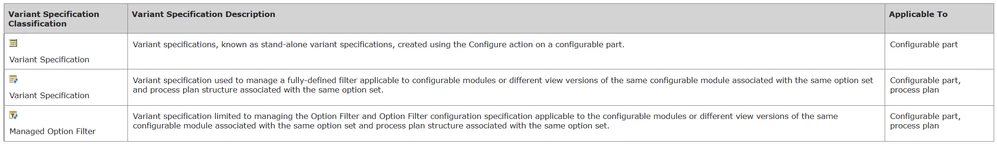

It seems that you can filter the Process Plan with a Variant Specification, but for some reason I cannot use the same VarSpec that was used in generating the EBOM and MBOM variants. I need to create a new Variant Specification inside the Process Plan Structure browser to get some different type of Variant Specification that can be used to filter the Process Plan.
Here are the different Variant Specification types as described in the Windchill Help Center:
The top most type is created when you configure a configurable product and the second one is created when you create a new Variant Specification from Process Plan Structure browser.
Also just filtering the Process Plan is not enough for our needs because we are planning to send the Process Plan to ERP through ERP Connector and filtering does not create a new, unique object that could be sent to ERP.
