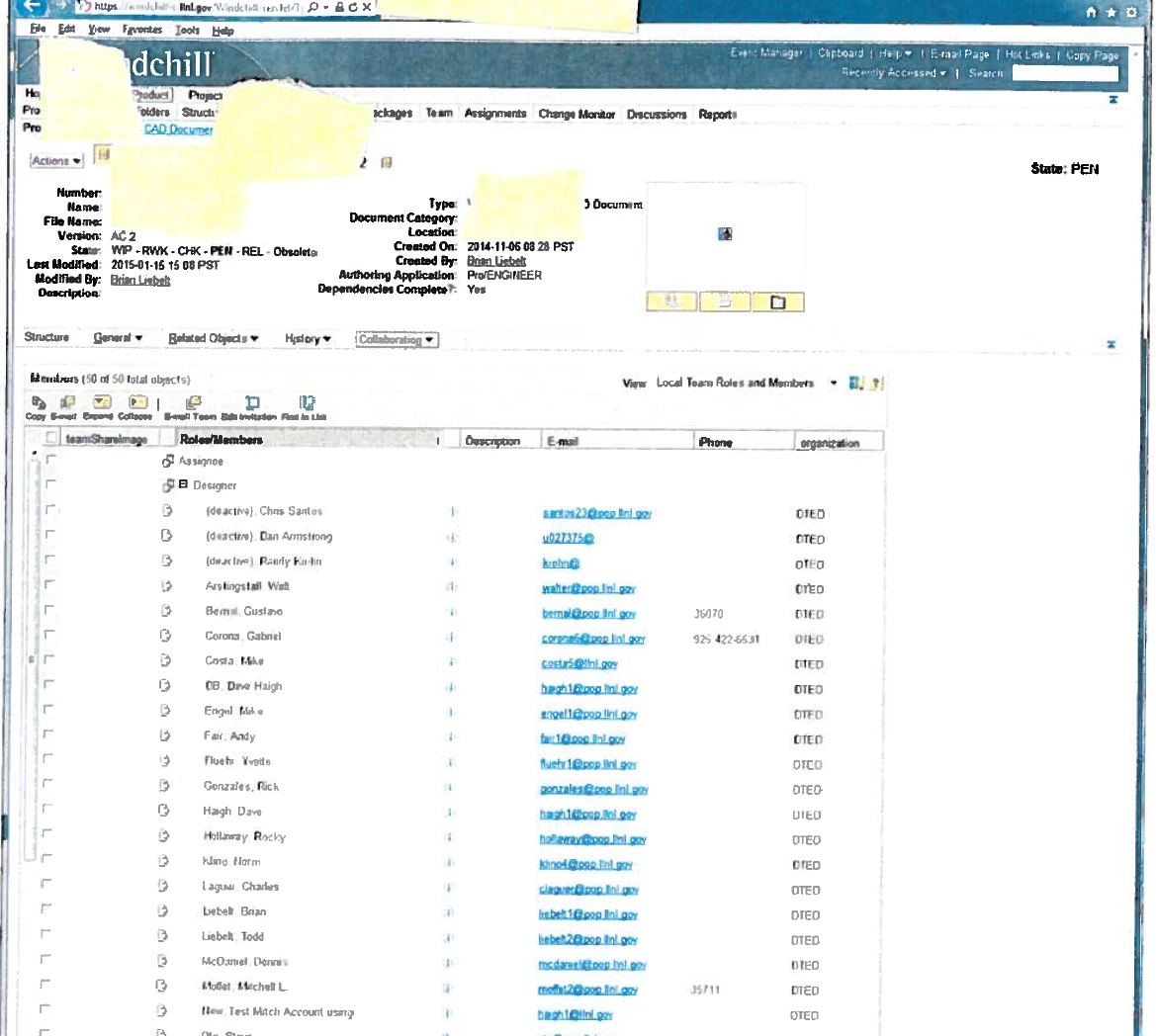

What's happening now is team membership for objects is not showing the groups. It's showing the individuals in the group.

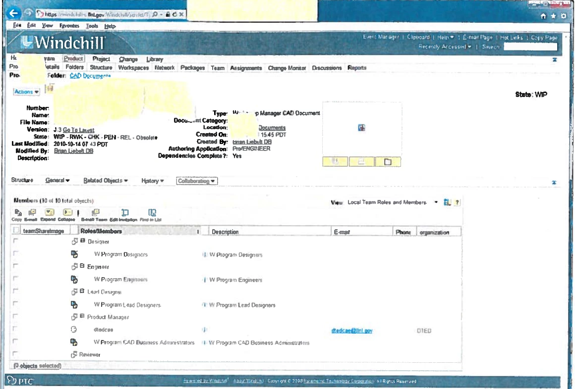

If we look at an old iteration of an object and look at Collaoration Team, you see the groups listed:

If you look at a new iteration of the same object you don't see the groups, you see the members of the group.
[cid:image004.png@01D04091.49A7E580]
Adding members to the group does not allow those new members to see the newer iterations of the files.
If you go to a specific iteration and pick Actions, Reset Team, the new users show up in the list.

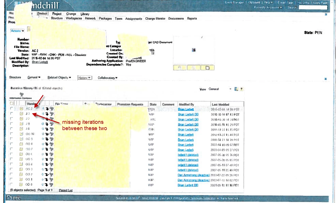

Now go look at what iterations that user can see and you will see a gap in the iteration history.

Sounds like a bug in copy teams functionality. Each object including
iterations have their own team. The team is initialized from predecessor
and or container teams. Make sense?
