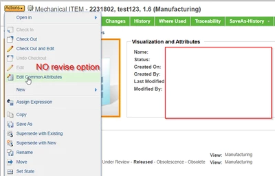

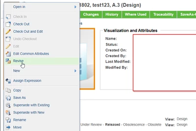

But what happened is related to the old manufacturing views in the system. The old ones have the previous lifecycle, which is totally fine. However, after creating the OIR, the system no longer allows me to revise the old manufacturing views. This is really weird because the old design parts that have the exact same lifecycle still have the revise option.

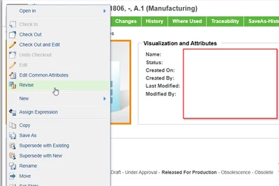

Somehow the lifecycle and view goes now hand on hand. I tried to assign new lifecycle to part which is manufacturing with old lifecycle and after the new lifecycle is assigned also the revise option became visible. Tested also other way and the revise option disappeared.
Did I miss something or is this normal behavior? Why OIR add on affects old items? Do I have to add or remove something from OIR?
With  ?jcadebug=tru
Lifecycle used for design:
Lifecycle what was used for design and manufacturing - no revise option. Tested with different rights.
If I try to revise part from BOM transformer it gives:
With new lifecycle manufacturing view does have revise option

So its the existing MFG views that are not in line with the current OIR and Lifecycle? You just need to change their lifecycle to the new one to clean up history. This should be easy to do from a search results. You can do them in mass and change the lifecycle template. That should resolve the issue.
VVII10-MarbleAuthor
May 17, 2024 12:52 PM UTC
Yes, the manufacturing items that already were in the system before the new lifecycle was created.
Ye that works if I want to change them all to match the new lifecycle! Tested and it is possible to change many items same time to new lifecycle.
I want to dive deeper and understand the logic behind this, I don't get why the revise option disappeared from the "old" manufacturing objects and stayed in design objects.
--> Does this mean that you can only have one unique lifecycle at the time per object per view? (in this case: mechanical item - (manufacturing) have only one valid lifecycle that must be used for all items)

If you revise, the system control the target object and if the target object's LC has the rights to create revision..
For example, if you revise object that has old Lifecycle template and new OIR rule would change the LC template to different one (which is possible) there has to be correct transition definition in both templates
