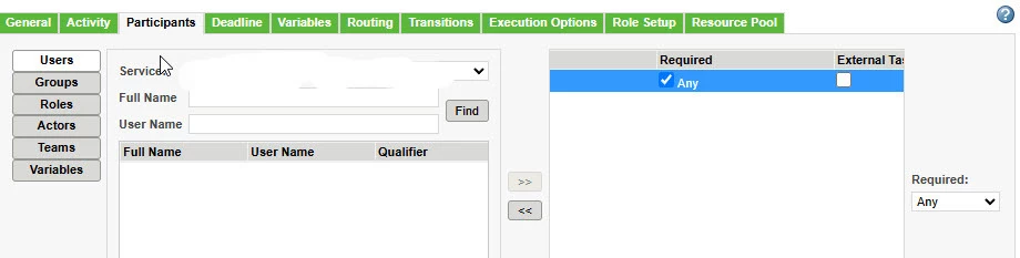

Hi ​@mddanyal,
Do you mean that, in the Set Up Participants tab, you want to be able to add a group instead of individual users?
mddanyal4-ParticipantAuthor
Jul 9, 2026 2:28 PM UTC
Yes
Jul 9, 2026 11:41 AM UTC
In the Change Administrators task you would set the CRB Resource Pool to a group.  You could make the group name CRB Master and put the groups you want inside of there.  Then on the CRB task you under the Participants tab you would make it required and then Any.  This is all OOTB.
Jul 9, 2026 2:32 PM UTC
This would mean that if I add 2 groups of 3 users each, the task will move forward if any 1of the 6 users complete the task. I need to setup such that, if 2 groups are selected, 1 user from each group should complete the task i.e 2 users
Jul 9, 2026 2:43 PM UTC
I would then set up a different task for each group and then have an And connector after.  If you only have one group that needs to approve then you would bypass the other task straight to the And.  You could have choices in the first task that could say Group A, Group B or Both Groups and the routings would go accordingly.
