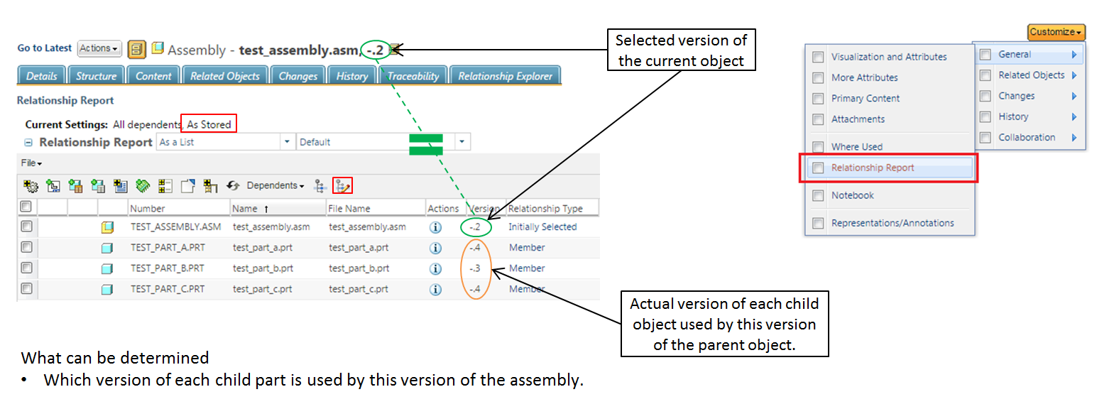

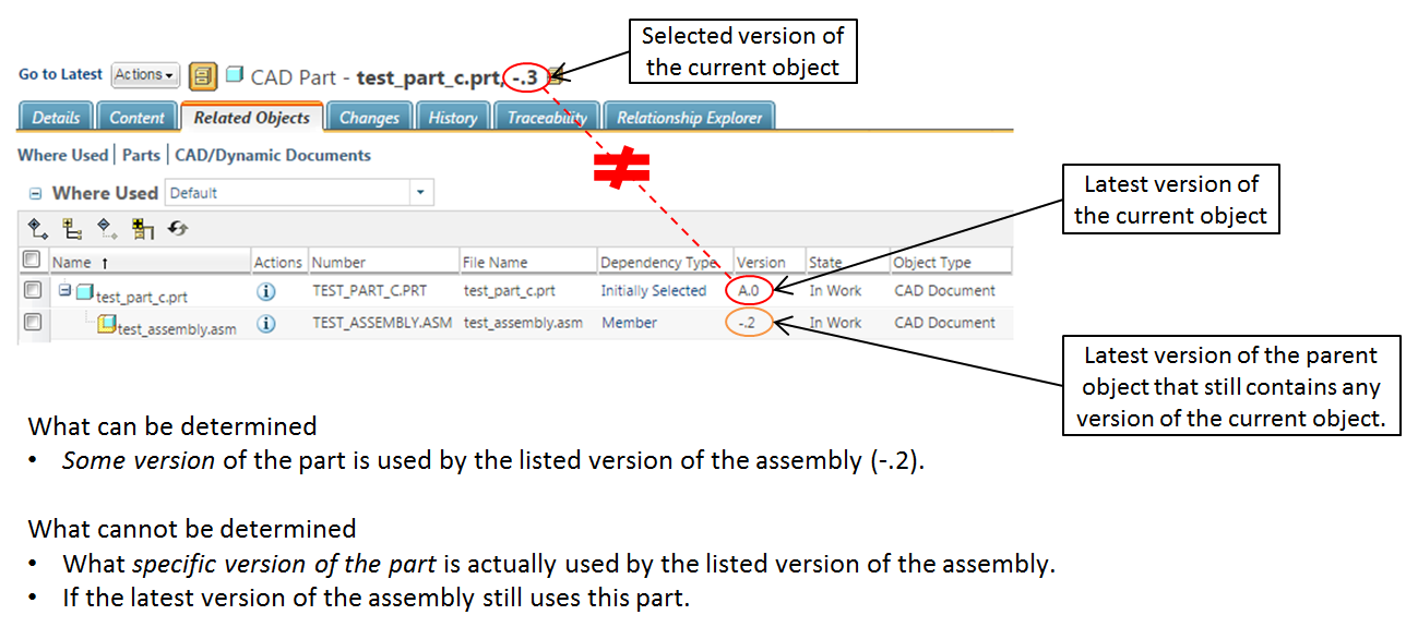

Oct 7, 2015 7:49 PM UTC
I just did some testing and I've think I've managed to wrap my head around the current behavior.  Please correct me if I have something wrong.
Where Used
Relationship Report (extra tab)
Oct 8, 2015 7:59 AM UTC
Hi Tom,
thanks for those screenshot, It is very informative.
However, this shows that there is currently no easy way to get what, I think, most people would want.
I believe it should be easy to implement what I suggested above. (A Querybuilder report can get it). Not only this would not change the interface of Windchill apart of adding two more column in the existing table but this would give great info in a straighforward  way.
I like when PTC introduced the Relationship Report but as you showed, it is complementary to the Where Used or the relationship explorer but once again to have a full picture the user as to open several pages...
