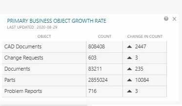

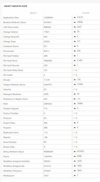

September 3, 2020
Hi Jeff,
in this document there are some reports that may be useful to you.
Some of the data you want to view are also present in the Performance Advisor for Windchill dashboard (see below images).
They are updated weekly.
Marco
