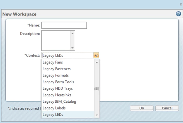

We are preparing to move from Windchill 9.1 to Windchill 10.0and we are in the middle of testing after our first rehearsal upgrade. We've run into an issue where users cannot see some project contexts when they are creating a new workspace. It seems like the user can only see projects where they are project manager. If they are a member (read, download)or designer (read, download, modify, ...) they cannot see that projectit in the drop down list to select. We did not have this problem in Windchill 9.0 or 9.1. Was there a change in the access policiesrelated to workspacesthat can explain this issue? Any help on how to resolve is appreciated.
In addition to the issue above, the context list drop down no longer shows the context type (i.e. Product, Library, Project) like it did in Windchill 9.1. (see attachment) This can cause issues since some of our projects share the same name with a product context. Is there a way to see the context type?
