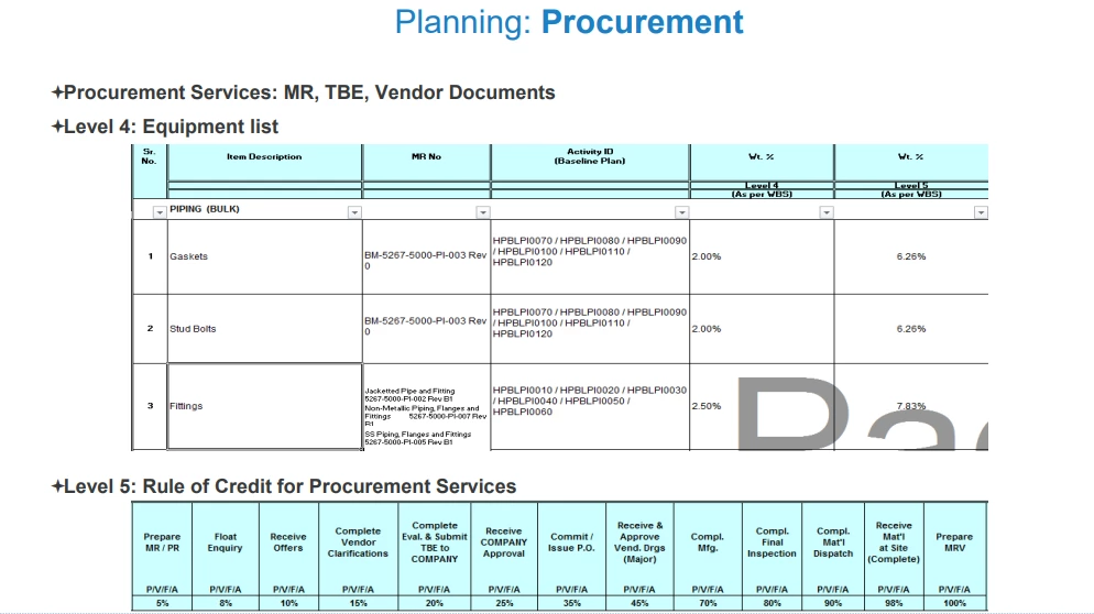

Mar 27, 2025 10:44 AM UTC
Thanks for the response. Looking for capabilities for managing a Engineering Project starting from Contract Initiation, Multiple Reviews, Audit,  along with the Schedule, Plan , Deliverables.
Also, one more query. Refer the screen shot. Is the weightage of the progress of a WBS work possible in Windchill?
This will enable the % completion of a WBS to reflect as per the weightages.

Mar 27, 2025 11:05 AM UTC
The ProjectLink module might be what you are looking for. It has all the things you are looking for to managed the schedule. There are a lot of better project execution systems out there but if you are looking to manage it all in Windchill, use the Projects feature. It does have the roll up on completion percentages.
https://support.ptc.com/help/wnc/r12.0.2.0/en/#page/Windchill_Help_Center%2FProjMgmtProjectAbout.html%23
