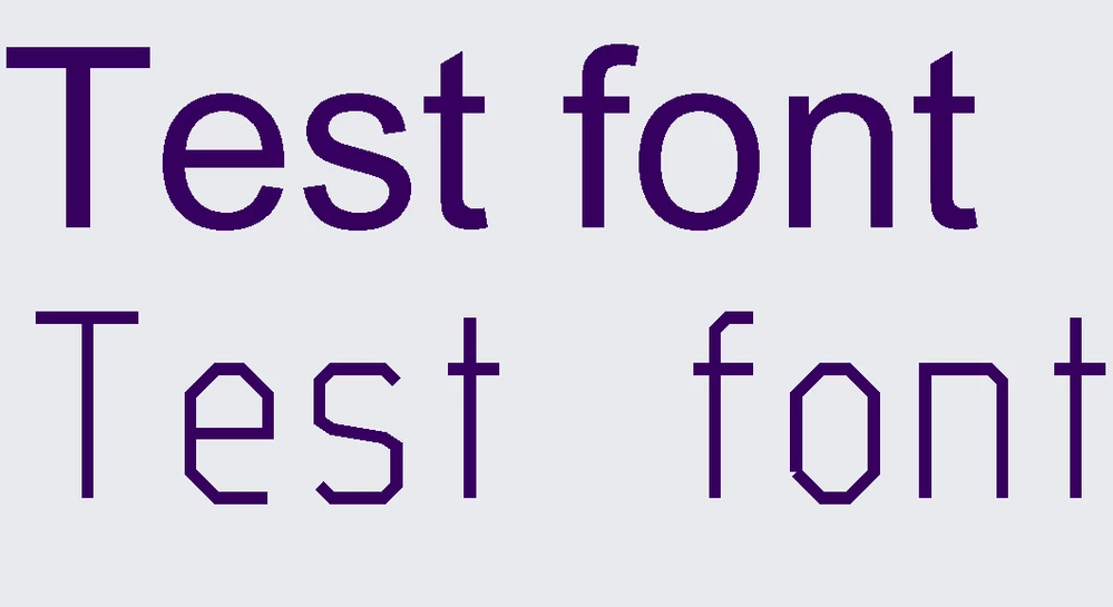

For a stroke font you can not to control the quality, I recommend to use a ttf font.

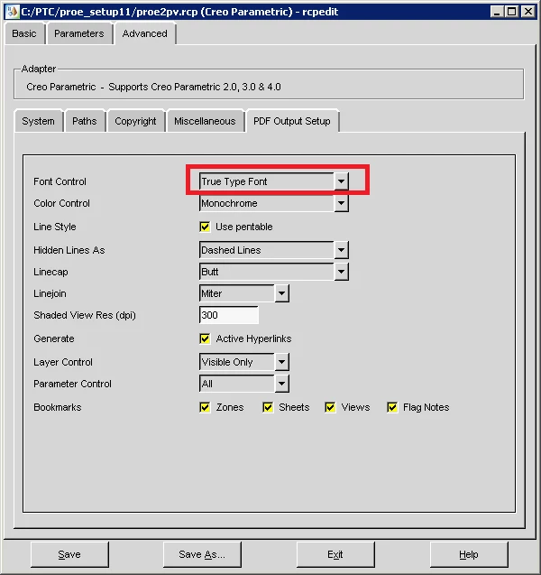

You can use the "True Type Font" value of the "Font Control" propertie in your proe2pv.rcp file.
And need to change your ndx font file.
