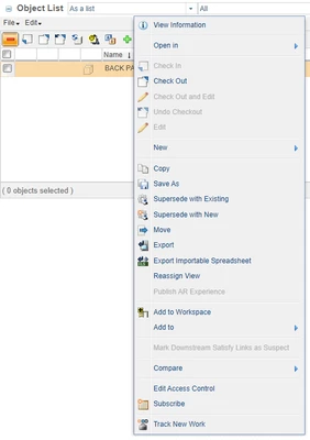

I have created Gathering part by mistake. Now I want to convert this into WTPart. But it is not showing any option while checkout and edit.
What is the solution? I want to use that same part number.

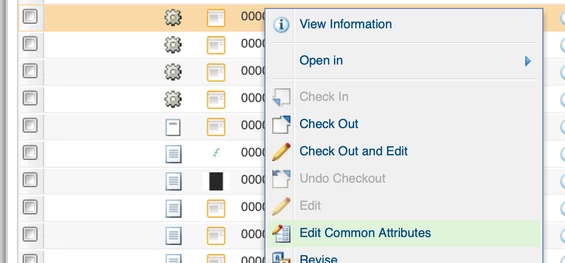

If you're a "normal" user then probably you don't have enough access rights (modify and modify identity) to change the attributes. So you need to ask an administrator.

The attribute is set on the "master", so you need to change it with the action "Edit Common Attributes".

Thank you for answer and support but there is no option for edit common attributes.
