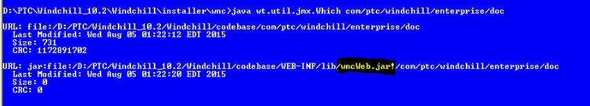

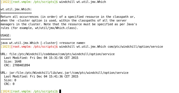

You can use the Which command to find out the resource jar for any class or package. From a Windchill shell, run the command java wt.util.jmx.Which

Kouryo - As underlined by Binesh, you can use "Which" utility from a Windchill shell with "java" or "windchill" using "/" (instead of .) in order to separate the various java packages
