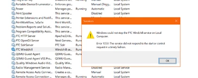

CPS 12.0.2.26 broken? Cannot stop Windchill Service. Error 1053
Version: Windchill 12.0
Use Case: Installed CPS 12.0.2.26 Try to Stop Windchill Service (e.g. for backup purposes)
Description:
When I try to stop Windchill service within "Services" or by running 'sc stop "PTC Windchill"', it would not stop correctly.
In "Services" I get an Error 1053:
'sc stop "PTC Windchill"' just reports "STOP PENDING", but nothing more (no additional error message).
After around 4 minutes, the service finally stops, but I guess, that windows just terminates all corresponding processes after a certain time.
MethodServer.log reports several
[Servlet engine stop] wt.system.err - WARNING: The web application [Windchill] appears to have started a thread named [xyz] but has failed to stop it. This is very likely to create a memory leak. Stack trace of thread:
I updated JDK vom 11.0.13 to 11.0.30, but nothing changed.

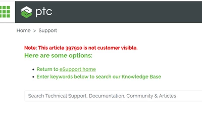

for the "The web application [Windchill] appears to have started a thread named" take a look at   https://www.ptc.com/en/support/article/CS397910

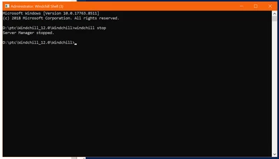

Next time try to use windchill stop command from windchill shell and check what errors thrown in the method server /server manager logs

Thanks for Your tip, unfortunately it is not working.
1. windchill stop reports nothing
2. The CS ist blocked for customers
Fadel
23-Emerald II
Mar 19, 2026 10:43 AM UTC
you are right , my bad article is PTC internal belo is a screenshot :
as windchill stop is ok ,  you  can uninstall and  reinstall the service see  https://www.ptc.com/en/support/article/cs17799 , this one is public 🙂
