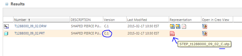

I pushed tech support pretty hard on this as well and received the same answer.  Answer from R&D:
There is no way we can support such a customization, and the tag I thought we might be able to use isn’t used in the class, so we would need to modify the compiled class which isn’t supported.
I created a product idea requesting this capability:  Dynamically Name Additional Files   The last response I heard on the idea was this:
They don’t have plans to implement this fix right away;
I can’t track the Product Managers schedule for when they might decide to implement it.
Our solution for the time being is to use Flexible Light Search from Wincom Consulting.  This tool will dynamically append the revision to the filename when the user attempts to download any additional file:
