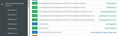

I don't think so, I've found ChangeTask method to create an object. (WCH 12.0.2.0)
There is also method to create ChangeNotice with Tasks
/CreateChangeNoticeHierarchy (check the help)
I can not find the method to create ChangeRequest so I suppose it is not possible OOTB. Just create own method for rest api could be possible in my opinion.
