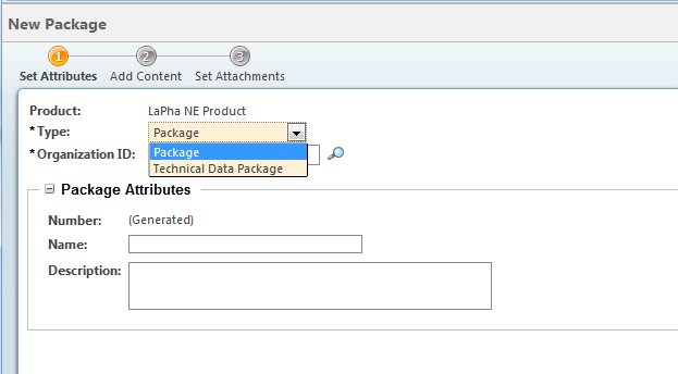

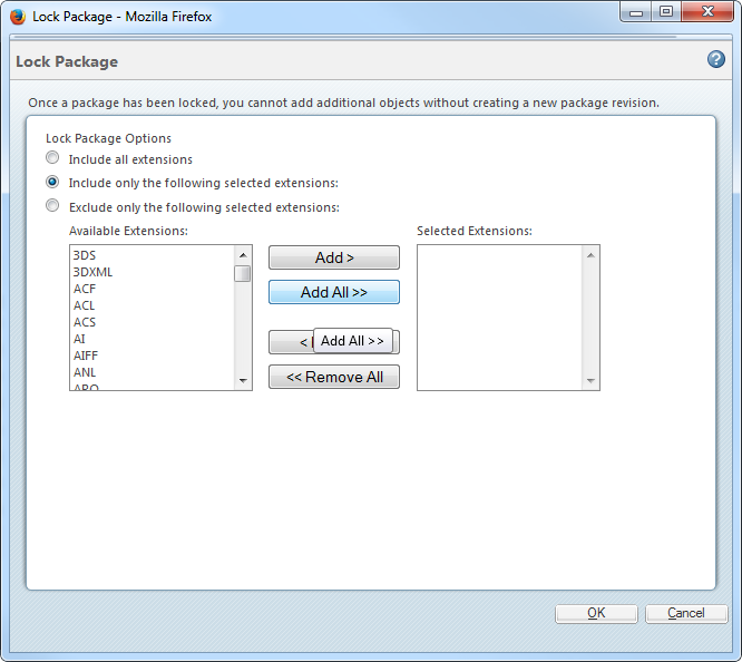

When locking the package you can set which file types get included/excluded. The downside is you have to perform this each time and know all the extensions.
What I've been looking into is customizing the Package Types. In 10.0+ there is an XML file you can customize with various Package Type Properties. It's listed under "Package Type-Based Properties" in the Help files. http://www.ptc.com/cs/help/windchill_hc/wc100_hc/index.jspx?id=WCCG_BusLogicCust_WorkPackTypes&action=show
The Type drop down shows up and lets you pick from the types detailed out in the XML file. These types allow you to control Included and excluded types of data.

I never received a proper answer. We discovered that you have to exclude all file extensions to receive only viewables.
