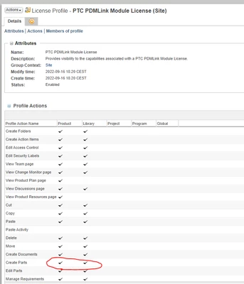

Oct 6, 2022 12:39 PM UTC
What version of Windchill are you using?
From 11.1, the actions you can perform depend on the license profiles you have been assigned to
Under Site --> Profiles you can find the existing profiles
For each one the actions available in the various contexts (Libraries, Products, Projects, etc...) are indicated.
See below image
