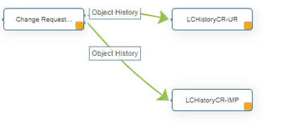

If you are looking for the date the lifecycle state was change not the last modified data of items in Released state, you'll need to use the Query Builder and join to Lifecycle history to Parts:
You can look for when the Action on the history equals "Enter_Phase" and report on the created date of the history object as your bound for "this year". note that you might get multiple entries if item was released and re-released.

I see, the change request and life cycle tables are the important tables to have.  On the next tab, "Select or Contrain", I'm going to want Life cycle, name, and date... still learning how the flow works with this report builder.
