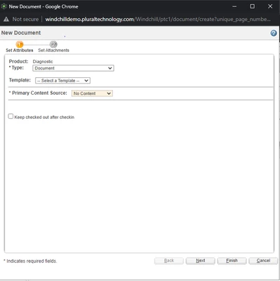

Creating a WTPart / WTDoc fails in windchill as name, number atttributes missing in Creation wizard
I am using Windchill PDMLink Release 12.0 and Datecode with CPS 12.0.0.2
Getting Error while creating WTPart or WTDoc using defaut template "Caused by: wt.vc.VersionControlException: (wt.part.partResource/19) wt.fc.InvalidAttributeException: The name attribute must have a value. "
Here are the errors that I faced

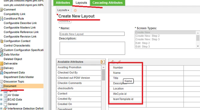

Hi @Rohaan
I know two cases of this error.
One is that system attribute Name is not in the create Wizard
The name is hidden or removed from create layout by Administrator in the Type & Attribute management
- add the name attribute back to the Wizard
Second is OIR definition. The name is not defined in the OIR or is defined wrong way or is pick-up from an another IBA parameter that is empty.
- correct the OIR definition

Rohaan14-AlexandriteAuthor
Aug 31, 2023 8:30 AM UTC
I probably think the system is broken because all the configurations are correct in Types and Attribute Management, yet I see no attributes .
HelesicPetr
Aug 31, 2023 8:55 AM UTC
HI @Rohaan
Check type & attribute management layouts
Be sure that the attributes are ok.
Sometimes I saw there were error in datautility if the attribute should have been shown but error stops loading full page.
Also if some js script failed it can stop loading full page.
In your case there is something that block full page load.
