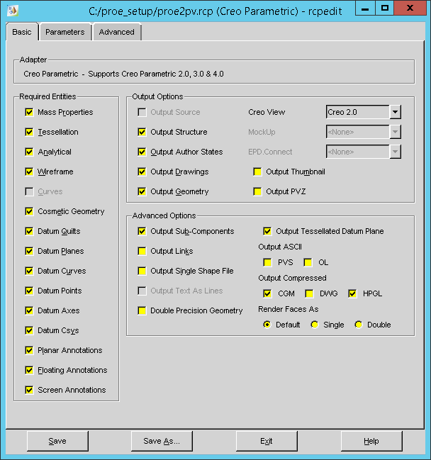

You must configure your adapter for converting dimensions, planes, axes and ets.

Do you have a visualization adapter for Creo Parametric data?
