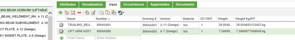

Creo mapped IBA like Weight kg/kit, Quantity/kit are not visible while creating BOM.
Dear all
The creo mapped attributes are visible in the product structure browser with exact values from creo but when we create the BOM the attribute values are not present in the respective BOM Columns.

when i want the BOM of certain asssembly then i go to psb and go to reports & generate multi level bom at that time the values of these creo mapped attributes do not reflect in bom table.

Hi @Vipul
If you need to show BOM IBA columns in a psb report you need to customize a report builder.
An article can help CS36882
General description in a Help Center CustBOM_WCCG_CustExistingReports
