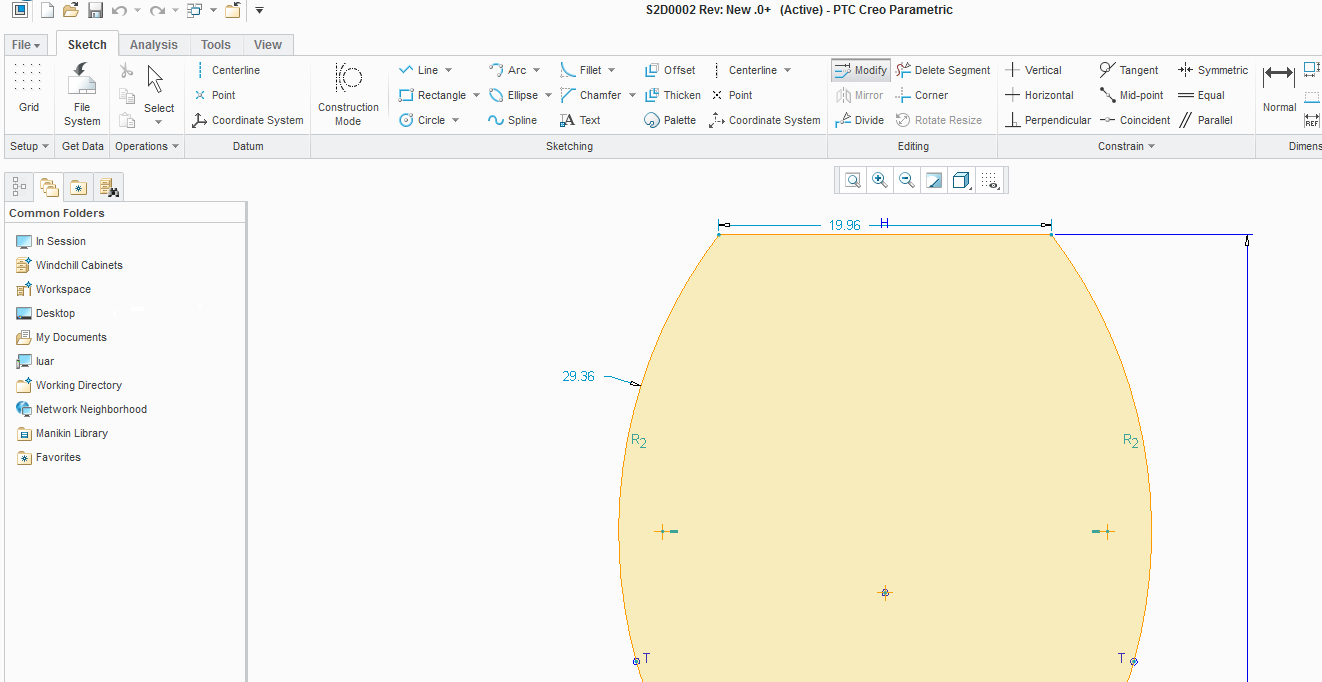

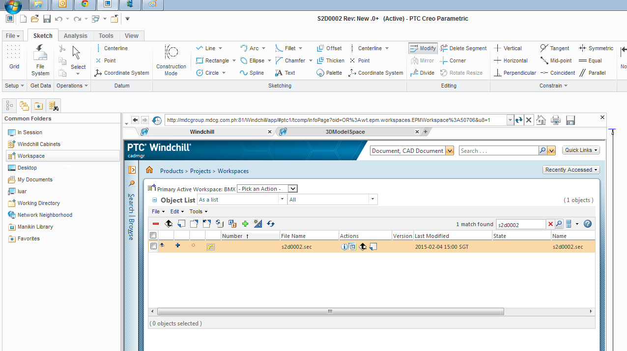

I'm creating a 3d drawing in creo and my workspace is in windchill. I save a sketch in my workspace and when I want to used the sketch that I saved to a new 3d model, it doesn't appear in my palette.
Please see the screenshot below.
This is my workspace.
This is the sketch that i want to open in my palette

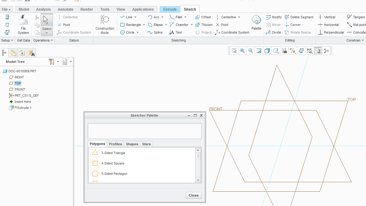

This is what appear when I used the palette in a new drawing.
