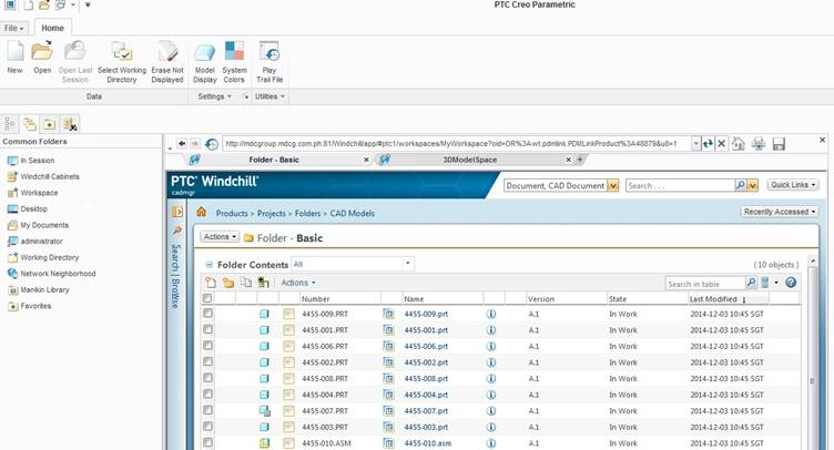

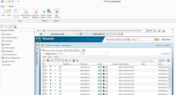

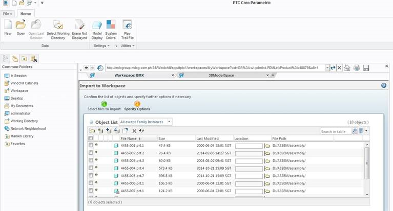

I import creo files in windchill thru creo.
After the Import and checkin the publishing/thumbnail is not working. What I need to do is to checkout the file and custom checkin and choose models and viewable so that the publishing/thumbnail worked.
The problem is the revision add even I didn’t change/modify anything just the custom checkin. Is there a way to import creo files in windchill and the publishing/thumbnail worked?

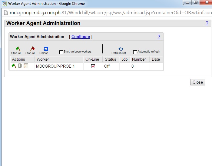

Luar,
Do you have a CAD worker configured (either a remote CAD Worker or local to the Windchill server) to perform the publishing within Windchill? Check Site > Utilities > Worker Agent Administration. If all you see is a blank list or a worker named "triumph" then you don't have any workers configured. In that case, the only way publishing will happen is if you do a custom check in and select to do client-side publishing (i.e. "check in Models and Viewables" option or just the "Viewables" option).

Hi Lori,
This is the screenshot of my worker agent administration. should I start it?
TomU
Dec 8, 2014 3:12 AM UTC
As long as it's configured correctly (and the CAD worker is configured correctly), it will automatically start when needed. What happens when you check in a file? Do you see this startup?
