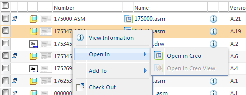

We are looking to get a program that our Tech. Publications can use to get different views of Parts and Assemblies for the Manuals.
I was looking at using Creo View for this but apparently you can't connect Creo View to Windchill.
So does anyone know what I can use to connect to Windchill and view our Cad Documents? I don't want to have to purchase a full blown Creo License for this simple task.

Two possibilites. 1) There is a setup issue with the install of Creo View or 2) Your Windchill installation is not automatically generating "viewable" files. Either way I would contact tech support and have them help figure out which it is.
Do you know if viewables are being generated in your windchill installation? There needs to be a CAD worker configured that automatically generates Creo View "viewables" Looks like you might be on Windchill 10? You might check with your Windchill Admin or Contact PTC Tech support and have them help you determine if viewables are being created or how to get that setup.

Creo View should be the tool for this. What version of Windchill are you using? Do your tech pubs folks have a windchill log in? Should be as simple as the tech pub people log into Windchill, they navigate to the details page for the part or assembly in question, then they click on the icon for the part or assembly and it then opens up in Creo View. Alternately from the details page you can choose Action - Open in Productview (or Creo View) Once in Creo View. Once in Creo View they can explode, hide, move component, etc. I have engineering techs and program managers here that do that all the time to create images for presentations, procedures, tech pubs, etc. (Windchill 9.1 M060)
Creo View, just doesn't work like Pro/E where there is an embedded browser to navigate Windchill, you have to log into Windchill and then launch Creo View from Windchill to view a desired object.

Would you know why I my Open in Creo View is greyed out?
I have installed Creo View from the Software Downloads page.

Got everything working and Creo View opens the files fine, but when trying to print them the option I want is not available.
"Under File>Save Current Set As>Save as Vector to see if you can export the sheet as a DXF. You may also try the Save as Image to try to export a JPEG or TGA."
I can't find Save As Vector. It is exactly what I want to do though, so if you could steer me in the right direction here.
All I have under File is Print, Send, Help, Options, and Exit.
Creo View Express 2.0 M030

Erik, By now you are probably aware that you will need to upgrade your Creo View Express to the Creo View MCAD version. This allows full vector conversion. We use it to create vector line art in our technical manuals. It works great because it allows the technical services personnel to completely de-construct a complex 3D model without using a 3D CAD tool like Creo Parametric.
