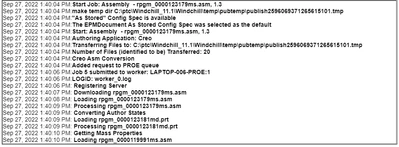

Hello. Please help with advice. I set up a worker to process assembly models. Each job stops executing at the stage "Loading *.asm". No further execution, I waited more than 5 hours. Please tell me what the stage "Loading *.asm" depends on and how I can influence the speed of execution?

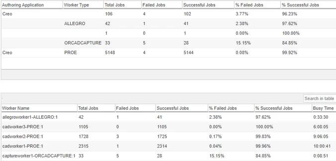

Generally, if there is a problem that a regular user might have, so will the publisher. We sometimes find assemblies that fail to publish. Examining the logs, you can often find the problem model which will cause all assemblies above it to fail to publish, poison pills. If you fix that model, it can fix the failures on up. That does not appear to be what you were seeing. Running in interactive mode will allow you to see what messages the publisher got stuck on. I will have to take a look at that config.pro since it has some good settings to avoid interactive messages.  Keep an eye on your stats. Here are mine:

There might be issues with the Creo. You can stop the worker and check with your trail file and if  you notice that Creo operations are stuck in the trail file then you can run proepublish.bat, this will open Creo in foreground. If Creo shows any error you need to fix that. Sometimes it may not show any errors but it may give some pop-up windows which might affect file processing in the background. In case if you see any pop-ups accept them and say remember my choice/Never show.
However this is very basic check I can think of right now. I hope you had successfully run a worker test after setting it up, to make sure there is no issues with the setup.
