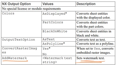

Creo View Adapters 11+ has a Watermarks option for NX!
Version: Windchill 13.0
Use Case: Automatically adding a watermark to published PDFs of CAD drawings.
Description:
Looks like Creo View Adapters 11.0 and above have added a watermark option for NX PDF outputs!!
I verified that this works on 11.0 Adapters and I'm guessing it's using the NX watermarking feature directly. These are all great things because in publish rules I can just add a watermark for the condition I want and it's done!

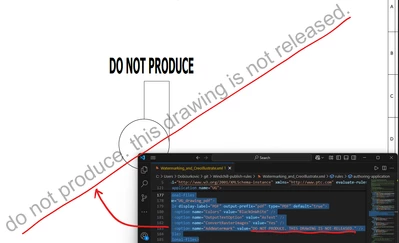

However: It seems to only add uncapitalized text...

Curious about the hyperlink... How about this? Creo View MCAD Adapters 11.1 Installation and Configuration Guide .
In my publish rules, the watermark test is all capitalized.
 <additional-files
 name="UG_drawing_pdf">
 <file display-label="PDF" output-prefix="pdf" type="PDF" default="true">
 <option name="Colors" value="BlackOnWhite" />
 <option name="OutputTextOption" value="AsText" />
 <option name="ConvertRasterImages" value="Yes" />
 <option name="AddWatermark" value="DO NOT PRODUCE. THIS DRAWING IS NOT RELEASED." />
 </file>
 </additional-files>
On the drawing, it shows up like this:
Curious if there's some sort of case conversion happening either on the Windchill end or NX... NX will display as written. Here, regardless of case the watermark displayed is lower case.

Looks like a bug to me. Did you log a case with PTC TS?
That said, I’m still a fan of pdfbox and writing one’s own code to watermark pdf files.
If you write your own code you have a lot of flexibility and you can watermark anytime, not just when publishing.
You can also set the text as a variable based on an attribute like state or whatever.
