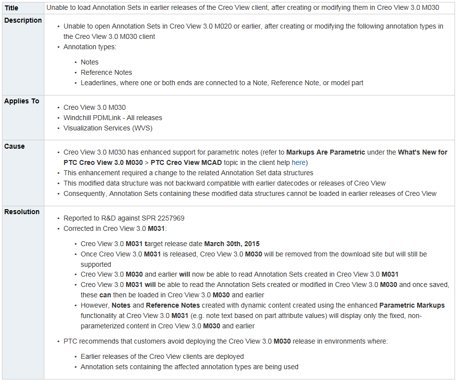

Curious if anyone has the back story on why there is a Creo View M031 being released? I haven't seen any dire warning about M030.
On the other hand, maybe it's a typo since M031 isn't listed on the downloads page.
TomU
TomUAnswer
Mar 26, 2015 5:34 PM UTC
Actually, I think I just found it (or at least part of it):
https://support.ptc.com/appserver/cs/view/solution.jsp?n=CS200381
TomU
TomU23-Emerald IVAuthorAnswer
Mar 26, 2015 6:04 PM UTC
Tom,
From an email PTC sent me:
https://support.ptc.com/appserver/cs/view/solution.jsp?n=CS200462

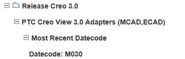

Marco Tosin‌, has the download for M031 shown up for you yet? I'm still just seeing M030.

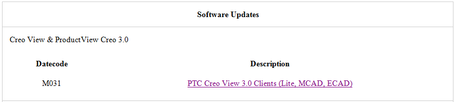

Apr 9, 2015 6:17 AM UTC
Tom,
yes I can see now M031 and I had install it last week.
