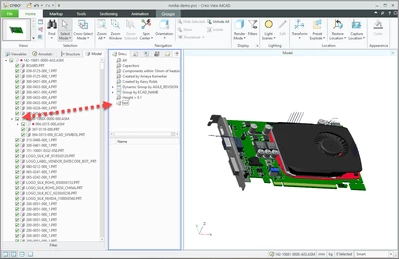

The easiest way I have found to do this is to create a group, and then add components to hide into that group (you can simply drag them to the group, or use some logic to auto populate it. When you open the model, then you just hide that group.
