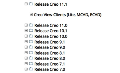

CreoView won't start from Windchill (or browser) by thumbnail nor 'open in CreoView'
Version: Windchill Below 11.0
Use Case: I want to open visualization of parts and assemblies on Creo View directily by Windchill. Our Client uses Creo 8 so that's what we use. I have just installed Creo 8 with everything in it (Creo View Express 9.1 included).
Description:
When trying to open a Creo View visualization by Windchill either by clicking on thumbnail (the thumbnail works just fine, zooms and rotates) or by Open in Creo View option,, this happens:
- On Windchill integrated in CREO: it just pops a IE error webpage that says its not possible to open this webpage, "Some content or files on the webpage require a program that is not installed". (windows_browser_type is now ie_browser, but was chromium_browser before and nothing happened)
- Windchill on Chrome it pops up a error message that says "Get an app to open this Creoview link."
- Windchill on Edge nothing happens.
Creo View Express 9.1 opens normally when opened standalone.
What should I do? What am I missing?

Creo View Express is NOT Creo View. Sorry for the confusion. You need to have Creo View installed. Its a separate install and download. Creo View Express is installed when you install Creo Parametric.

Thanks for the reply!
So I need to download and install Creo View (not express).
Would you help me find where to download it? Is the licence for it included on Creo Design Essentials?
avillanueva
23-Emerald II
Dec 13, 2024 7:53 PM UTC
https://support.ptc.com/appserver/auth/it/esd/product.jsp?prodFamily=DVV
There are licenses for Creo View MCAD/ECAD and others. Creo View Lite is not licensed.
