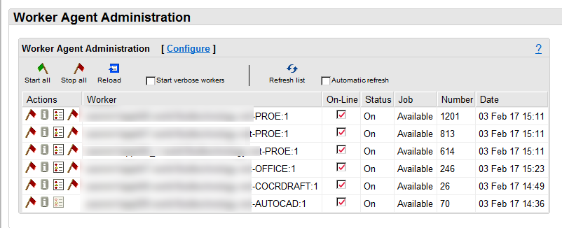

Feb 3, 2017 2:22 PM UTC
We are able to create a custom AutoCAD worker using this Any DWG to PDF converter (DWG to PDF Converter - AnyDWG).  The only we face is that the this custom AutoCAD Worker is not stable when running in Windows Window 2008 R2 (did have time to try it on 2012 or 2012 R2); however, it is running fine on Window 7 Professional.  The other issue is some conversion took longer than 10 min., that is why many of our published turned out failed due to 600 sec. timeout setting.
Feb 3, 2017 2:27 PM UTC
This is out settings:
