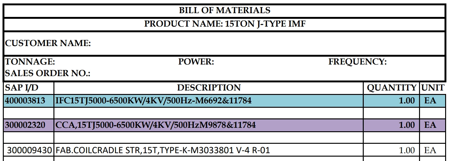

Trying to achieve a custom BOM report as per customer in Windchill 12.0.2
Attached is the format for the same.
Any suggestion would be really appreciated.

I've done custom stuff like this.
In short, write a utility that gets all the BOM info and then passes the info to a JSP which has code to loop through the info populating the table per the image you posted.
The JSP can be run from the WTPart's info page thus one click and you get the BOM formatted the way you want it.

I got this working.
From WTPart's action menu one click opens page that can be printed as pdf.
Part numbers order is sorted alpha-numeric.
Quantities are summed recursively thru multi-level BOM.
A number appears only once but it's quantity is summed each time it appears in the multi-level structure.
If interested see attachment.
