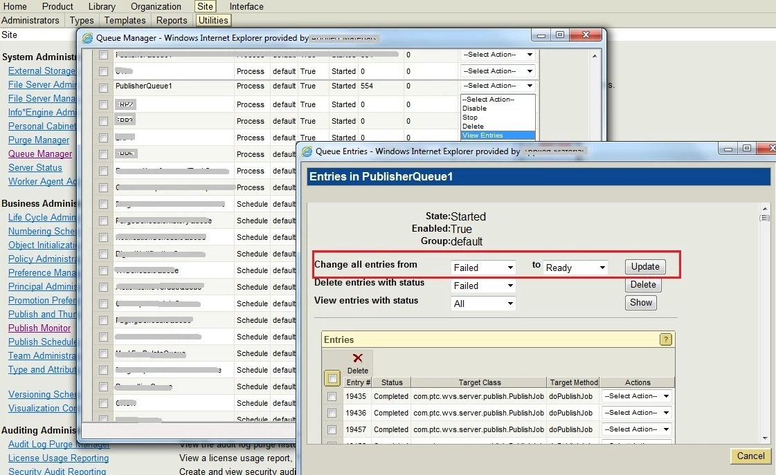

Does anyone have the code to republish failed jobs in the publisher queues? There's no OOTB job to do that.
Apr 30, 2012 11:25 AM UTC
Go to Queue Manager and for affected PublisherQueue# update the failed entries to ready. See attachment.
