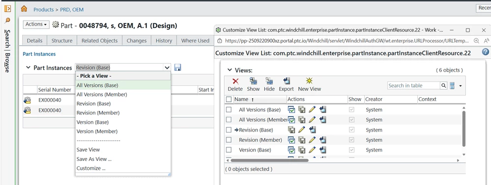

Customize 'Part Instances' Table View
Version: Windchill 13.0

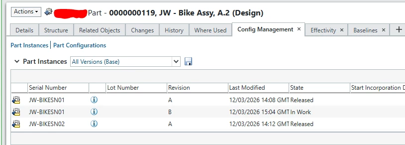

Use Case: Please refer to the attached image. As it can be seen, the table contains three objects. It can be seen that two of these objects represent two different revisions of the same part instance ('JW-BIKESN01' at Rev A & B).
Description:
I would like to configure Windchill so that the table only shows the latest revision of each different part instance. Is this possible?

23-Emerald II
Mar 16, 2026 1:54 PM UTC
This is not an easy task, we  can tweak windchill to make the table customizable , but the real issue is that partinstance type doesn't have an attribute  "SCA|isLatestVersion" like wtpart that we may use to filter latest version

Mar 16, 2026 7:21 PM UTC
Thanks Fede. If it's not too easy to do, I will relay this to my customer and provide them with advice on how they can customize the view of the "Part Instances" table to make it as easy as possible to identify the latter revisions of the same part instance objects.
