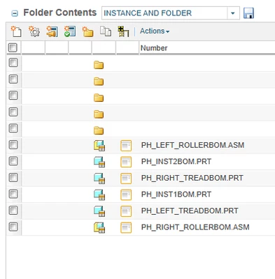

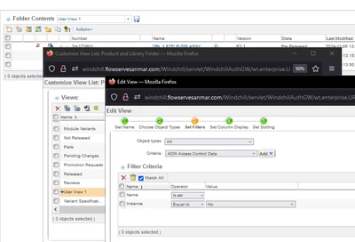

Hi Guys,
Can we restrict multiple objects in the Windchill customize table? If I try to hide an instance, I can hide it. I want a folder structure also, but that automatically hides.
Amir

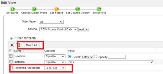

Hi @Amirtharaj_K
It is simple.
You have to specify OR condition. Not AND.
Also you have to find an attribute that can be used in the condition that shows just the folders.
the best attribute is authoring application. All CAD Documents have the authoring application value  set but the folders do not.
So
the folder result>
PetrH

Dec 9, 2024 4:28 PM UTC
@HelesicPetrYou are really a lifesaver. Thanks for sharing your knowledge with me. It's functioning as you predicted.
