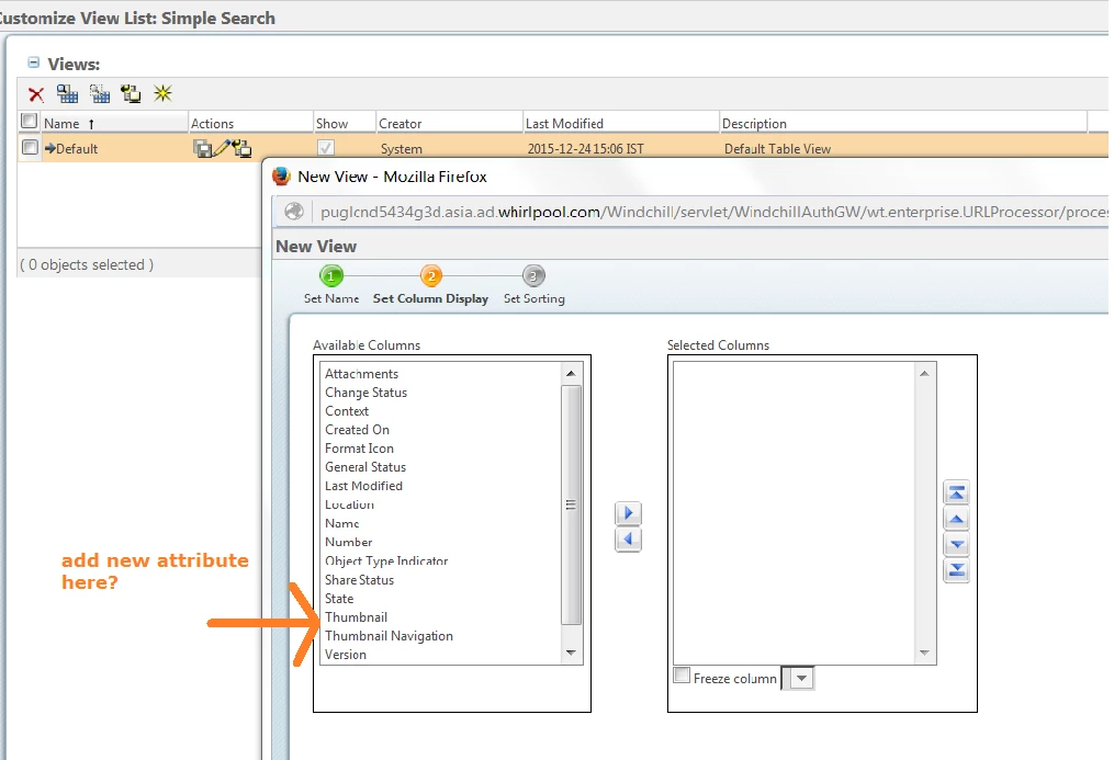

Is there any way we can add new attributes in the Customizing Table Views, when I try to create a new custom view I can see the some attributes are missing is there any way we can add it

Hi Mahesh,
Here is the steps I am following.
step 1: Search for the WTPart
step 2: In Search table select custom view
Step 3: Add attribute here (some attribute are not there )
2-Explorer
Mar 16, 2016 2:57 AM UTC
In you search criteria make sure you have just the part type selected. Then it will display the default part view and you can customize that view to add your attributes. For the users you can create saved searches and expose it

did you validate that your attribute is filterable?
