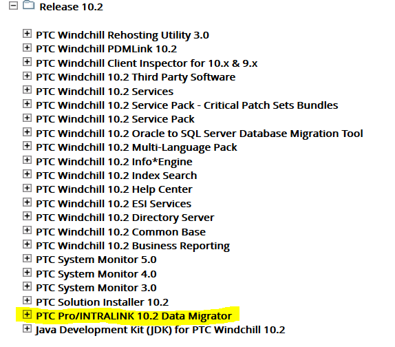

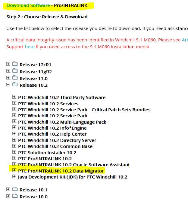

PTC has the "Pro/INTRALINK Data Migrator" which will migrate your data from Intralink 3.x to Windchill PDMLink or Windchill Intralink. This tool will migrate the entire history of Intralink 3.x into Windchill. It also migrates the file vault(s).
I used this tool to migrate from Intralink 3.4 M060 to Windchill PDMLink 9.1 M050 several years ago. It worked good. That being said it took me several practice runs using test servers and multiple calls to tech support to get the process down.
Link to admin guide:
http://support.ptc.com/WCMS/files/157210/en/ProIDataMigrator.pdf
It appears that Windchill 10.2 M030 is the last supported release of Windchill for this tool. You can find it in the Software downloads for Windchill PDMLink or Pro/INTRALINK:

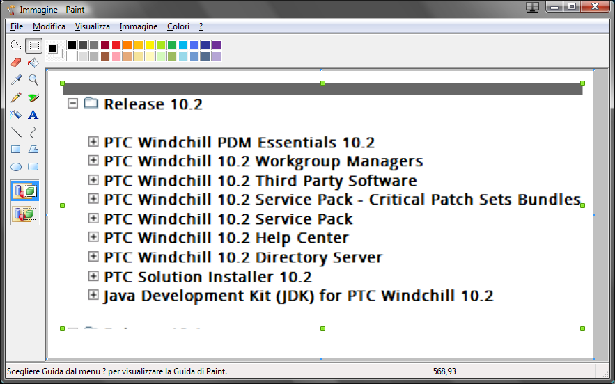

mamobono10-MarbleAuthor
Jan 27, 2017 3:36 PM UTC
thanks but I only see this among the downloadable software
ask for assistance
I have 6,000 drawings to import !!
I thought of going through other release,
I can not think that the developers have not provided the move
Good weekend

Jan 27, 2017 4:15 PM UTC
Since you have Intralink 3.4 do you should have a Pro/INTRALINK download option?
