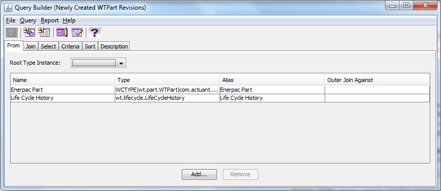

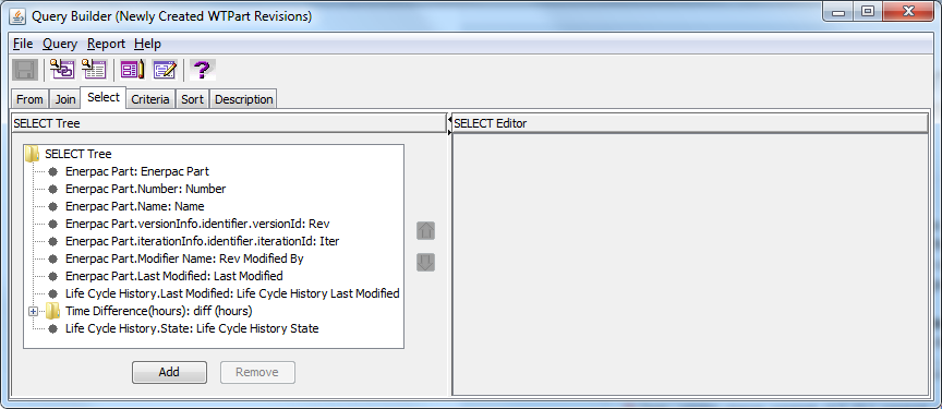

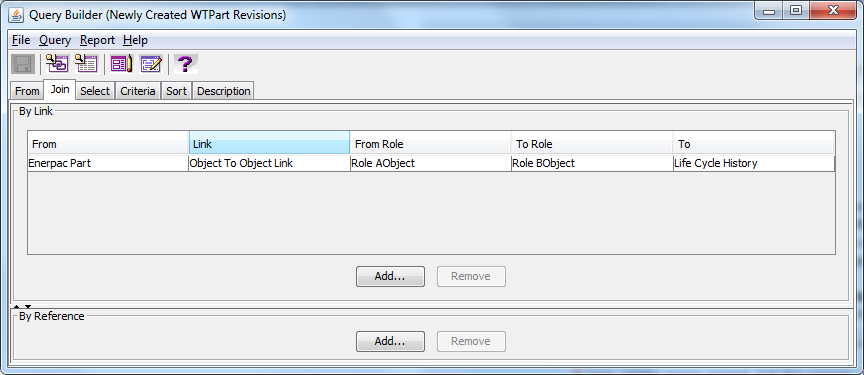

Perhaps in fact you're looking for the LIFECYCLEHISTORY table? Here are some screenshots I have of a report for a soft type WTPart. I can't "View SQL". I think is is because my FROM clause contains a soft type, not an OOTB type. This is from 9.1.

Reporting WHEN various events happen is a key need for almost every Windchill system - but is a bit challenging with the reporting provided.
Need to be very precise in defining what is desired:
- When the product data (e.g. Drawing) changes state
- When a related change object (Request, Notice, Task) changes state
- When a related change object workflow task is completed
All state changes are in the LIFECYCLEHISTORY table and can be accessed via query builder by joining Lifecycle History with the Object History association. Need to add to the Criteria Event = Enter_Phase (constant). Workflow task results are separate - they are in WFVOTINGEVENTAUDIT generally.
A bit more challenging to build relationships from the product data >> related change object >> state change of the change object.
Almost everyone has the need to report for example for the last month / quarter / year metrics like "how long did it take on average to get from a submitted change request to an approved change request" or "how long did it take from having an checked Change Task until the product data was actually brought to Released."

Aug 21, 2014 1:14 PM UTC
Is there a reason you did this in SQL versus Query Builder? It is much more straight forward to do in Query Builder then to try to reverser engineer the SQL.
