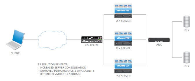

When discussing with "classic" virtualization topics in mind when it comes to Windchill Clustering, we are more enclined to consider specific VLAN with specific LUNs associated to dedicated ESX Farms. Using this categorization over the network, we can completely load balance according to the network characteristics and best possible performances.
Presented hereafter is a typical infrastructure based on F5-BIG-IP (for Load Balancing) and F5 ARX (for Intelligent Virtual Storage Management)
Ideally ESX Servers are allocated to specific VLANs and from within each VLAN, we can also distinguish specific network segments where regular loads can be higher than with others and with a specific configuration on the F5, we can micro-load balance over those segments within the same VLANs.
Please keep in mind that I have provideda limited example of configuration which may allow to understand how to consider F5 Hardware components within a Virtualized Network where Windchill Clusters are hosted on ESX Servers and connected to Virtual NFS through ARX or even using NetApp.
HTH!&VBR/H
