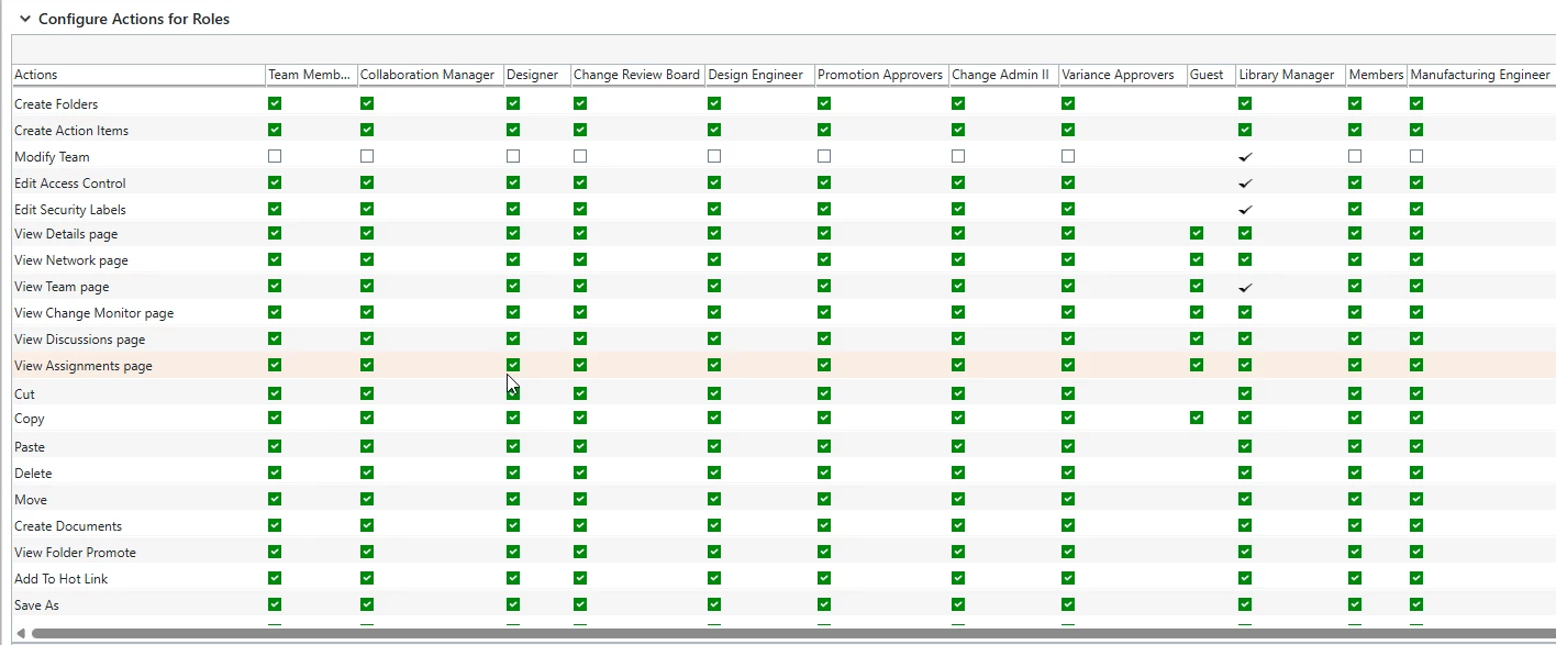

Default OOTB role action config
Version: Windchill 13.0
Use Case: windchill roles has too permissions, When checking in our teams section within our template then going into the configure actions for roles i find what the image attachment shows.
Description:
Hello all
The problem here is roles within this system have been given completely complete control of everything. i am seeking help in finding the default config for these roles to clarify a base before attempting to fix them. i have yet to find much when looking to this. i would appreciate any help on this!

Mar 12, 2026 8:16 AM UTC
There is no OOTB setting , the setting there is based on context template used .
+ These setting decide only on  action visibility, even action is  available it will fail if users are missing ACLS
