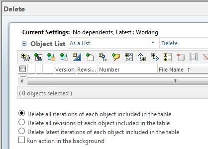

Default option when deleting
I don't think there is a preference but wanted to check with everyone.  Is there a preference that allows me to change what the default option is when trying to delete something?  I would like it to be Delete latest iterations of each object included in the table.

I am not sure what Windchill release your currently using, but I look at Windchill 10.2 M030 codebase and it looks it is hard coded in wt.dataops.delete.processors.DeleteStepProcessor.class file. And I do not find any preference/property which controls this behaviour.
Shirish
Shirish

We are on 10.1 M050.

I found same file is used for 10.1 M050 too.
