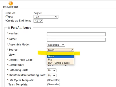

Default "Source" attribute for WTPart in Windchill PDMLink to be blank before clicking dropdown
  • August 17, 2023
  • 688 views
Can we default this value to empty initially, and not to MAKE. Only when users select the dropdown, they should be forced to pick a value because it is mandatory.

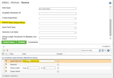

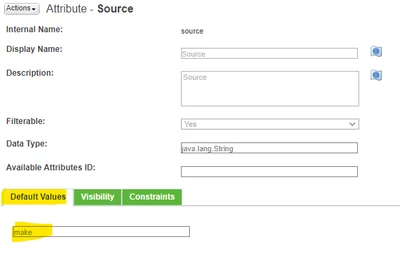

HI @RG_10753677
Just remove the default value from the type and attribute management and that's all
