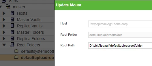

defaultuploadrootfolder can't not use unc apth?
i want use unc path to setting filevault path product is support? because always fails

Tech Docs say you can but some caveats.
https://www.ptc.com/en/support/article/CS31717?source=search
https://www.ptc.com/en/support/article/CS187332?source=search
Appears to be related to running Windchill as a service.
