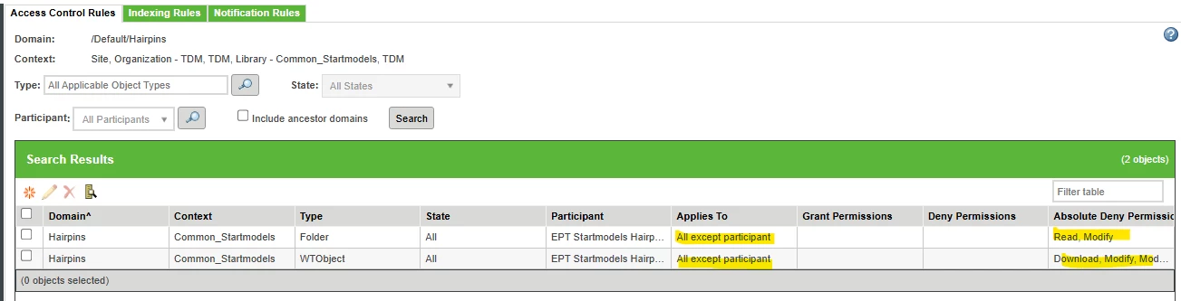

Delete ACL applies to all except participant by delete acl utility.java
Version: Windchill 12.0
Use Case: Delete the ACL in domain by using Utility by running windchill command in shell
Description:
we had a utility for deleting ACL, we are using this for deleting ACL from backend in various domains.
that utility is deleting Group assigned ACL and Role assigned ACL, but it is not deleting ACL which is group assigned ACL applies to "All except participant" principal.
when we tried to run ACL delete utility, it is returning error for above applies to "All except participant". error message is "Resource bundle/Message key = wt.access.accessResource/38".
I need a suggestion on this to how to solve this and how can i change or implement the logic to delete the ACL which is applies to "all except participant" and have absolute deny permission sets by this utility.
Used API is:
AccessControlHelper.manager.deleteAccessControlRule(localAdminDomainRef, objType, localState,
localWTPrincipalReference, false);
getting logs from my delete utility where it fails:
deleteACL
ALL Parrameters :wt.fc.WTObject
sLCState: ALL
localState :null
localWTContainerRef :Common_Startmodels
localAdminDomainRef :Hairpins
Get Internal Role or Group Name
groupForName = EPT Startmodels Hairpins SF Pool Grp
localWTPrincipalReference :EPT Startmodels Hairpins SF Pool Grp
ERROR: Couldn't find rule! Message:  Resource bundle/Message key = wt.access.accessResource/38

Are you using the GUI or a command line to do the deletion? How many ACL lines in total do you have to delete?
Jan 7, 2025 12:46 PM UTC
by command line.
in windchill shell, we are using "windchill ext.org.utility.ACLUtility <adminusername> <adminpassword> <inputfilelocationpath>
like this and all the loggers, i am using csv to append in java it will give me the csv with logs in windchill temp location.
whatever above you seen the table, that are from CSV output of utility.

It seems to be saying that it cannot find the ACL. If there are not too many and you think its a glitch with the utility, is manual deletion possible via the GUI?
Akash.S_12110-MarbleAuthorAnswer
Jan 15, 2025 4:43 PM UTC
I got the usage of API of this delete AccessControlRule:
here in above false represents allExceptprincipal is false.
for deleting all except participant ACL, we need to use true in place of false
localWTPrincipalReference, true);
but for this, i need to get the ACL, if it had allExceptPrincipal is true or false, as per this, we need specific logic to use above API.
AccessControlHelper.manager.getAccessControlRule(localAdminDomainRef, objType, localState,
localWTPrincipalReference, boolean)
