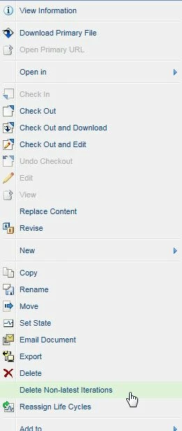

Hello everybody,
How delete old iteration ?
exemple : In Windchill we hawe A1 - A2 - A3 - A4, I want delete version A1 - A2 - A3 and keep A4 version.
in windchill 10 with right click on the document there was "delete old iteration" but in windchill 11 this function has disappeared
and with fonctionne delete, he propose me :
1. Delete all iterations of each object
2. Delete all revisions of each object
3. Delete latest iterations of each object
Sorry for my english, and thanks

"Delete Non-latest Iterations" is on my Windchill 11.  The screenshot below is from doing a right click on a searched document.  Does the user have Delete privileges?  Are there iterations of the object in question?

I just saw that we have this message with right click "Delete Non-latest Iterations" with certain fil types (.dwg .tiff) we don't use article in windchill...
but with creo elements (creo 3D and drawing) this function isn't available...
Jan 24, 2018 2:45 PM UTC
One work around is to use "purge" which, unfortunately, is only a site or org level utility, but it will do exactly what you are looking to do. Regards, Dan N.
3-Newcomer
Jan 24, 2018 3:47 PM UTC
Hi Dan, thanks for your reponse, yes it's exactly that, we use purge when we work with windows, we can use it with winddchill?
Jan 24, 2018 4:15 PM UTC
Yes, you can purge in Windchill.  It's a utility under the site and org, so if you have site and/or org access, you should be able to run the purge utility.
Dan N.
