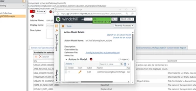

Hi ,
I want to delete a String Organizer entry created using Text Tailoring utility.
I can see only Edit and View Information option.
-Anjali

can you add some screenshot ?

Please find screenshot attached.

you are right same on my side , looks like an issue (You may open a TS Case to fix ) . looking for a workaround

seems to be a gap , that action model has only edit , there is no delate action , its not somethig hidden :
